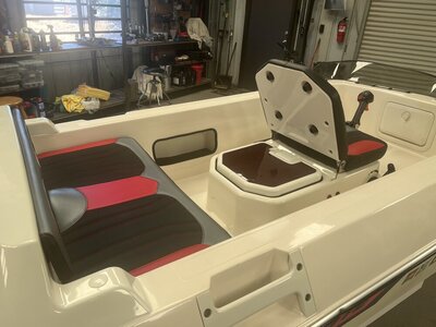

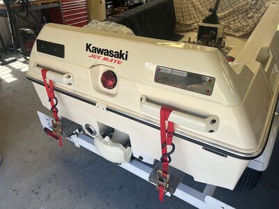

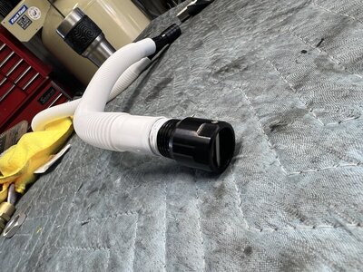

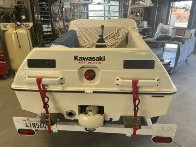

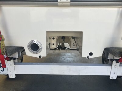

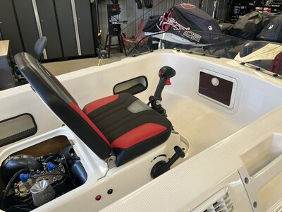

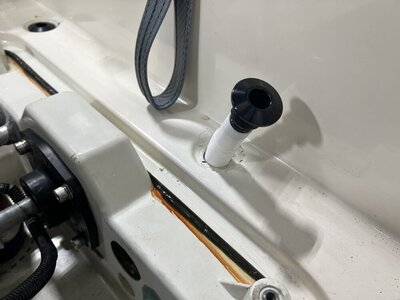

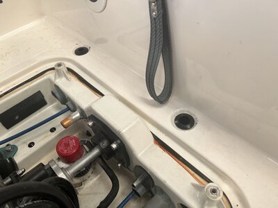

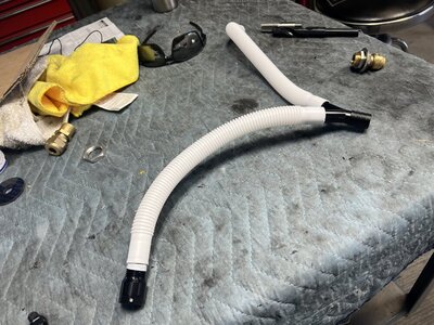

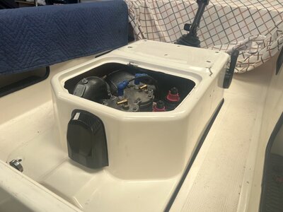

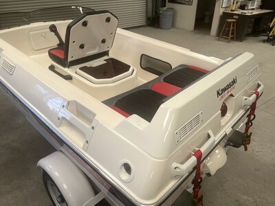

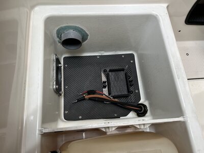

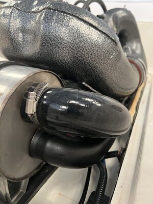

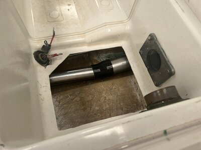

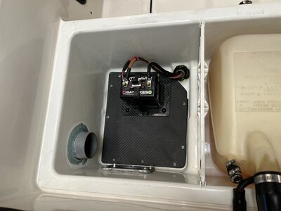

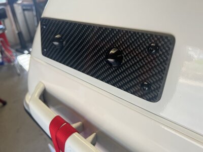

I've made some significant headway on the Hot Tub. But, I didn't plan on diving in this deep until next winter. After digging out as much of the saturated foam as I could get to, I plumbed in two 1/2" water lines. I also ripped out the old plastic Home Depot deck drains and installed my own system. It's 2 bilge fittings, Y'd together, and then routed out back to a 1" Versaplug. I also added two micro Versaplugs to drain any water that ends up in the very back of the boat. Exhaust is now straight through 2.25".
E2711B02-5F52-4BAF-A220-014FE6796314.jpeg108AEAFC-1C94-42D6-A65B-2D7C1A08B2B3.jpeg71A1896D-B122-4712-80A7-412382283CB9.jpegD6B8E613-69E9-4186-B4A8-B6211A1AE2E2.jpegC6158067-86BD-4208-9D68-BF5CA1304F09.jpeg16BD67EA-521F-4F61-857E-A2FCC223B661.jpeg5B90376F-CFD4-4BD7-A96C-63CC7EB092AC.jpeg

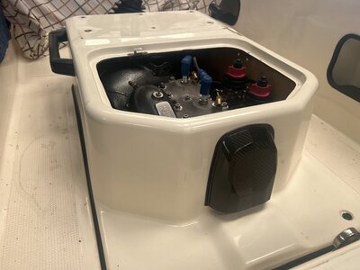

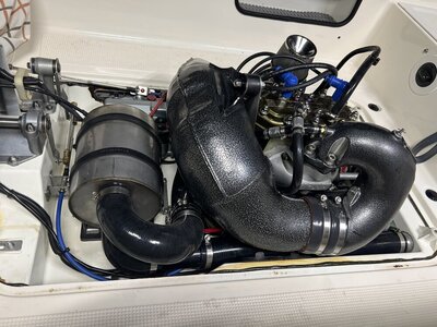

looking good. What the plans for the water box? Are you going to make the inlet & exhaust bigger.

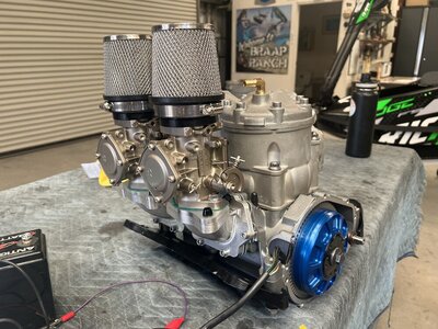

For now, I'll just keep the stock water box as it is. Surprisingly, it works really well. I was able to get the plumbing to and from the pipe without any kinks or rubbing. The ID of the inlet and outlet of the box is 1/2" smaller than the new exhaust tube that I plumbed in. But, that doesn't appear to hurt performance - Yet. This motor is a stock 750 small pin, with the only mods being a 46mm SBN and the Factory pipe. When I go to a bigger motor, I'll rethink the waterbox.
