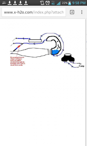

Hey guys, I finally got my hands on a Factory B Pipe exhaust, and Man does it rip! I had a question for you all since the answers out there are pretty vague.
After installing the pipe the mid range is non existant. it'll have a good low end response and top end is crazy good. But getting it out of 5 mph mode is a challenge. Usually i have to lay off the gas a few seconds to let water pressure subside , then a full zero to max throttle works just fine.
After researching on the forums, i guess its related to pop off pressure and jetting etc? I have a Blackjack buckshot 44 sbn carb with stock spring, needle, seat, and jets. I just ordered the low and high speed jets recommended in the Factory Pipe install guide. Also used their recommended carb low/high settings. I had the water screws on the pipe all the way in except the bottom is 3/4 turn out (recommended). Any other suggestions? Thanks fellas
