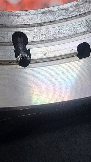

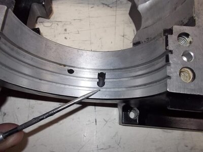

As we pressurized the motor with only one rear crank seal installed, we saw that air was leaking out of the engine faster than we could put air in. We quickly realized that a “cast-in” oil galley in the top case (meant to bring oil in between the two rear seals) was completely bypassing the inner rear crank seal …. Thus making this inner-rear crank seal 100% useless and without purpose. This meant that the single-spring outer crank seal next to the drive coupler was the only seal offing any sealing properties at all for this engine. It bears noting that ALL valved GP800 and GPR1200/1300 engines have exactly this same defective feature.

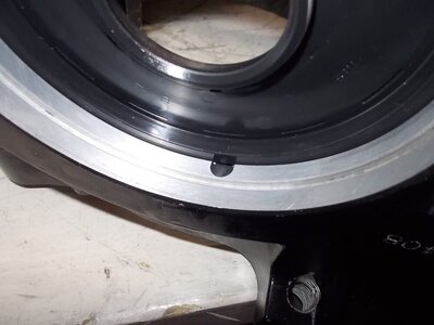

The only solution for this problem was to fill the offending galley with a high quality epoxy, and then dress the hardened epoxy down to match the machined seal holding surface of the case … and we do so.
Afterwards, we once again pressure tested the engine with only the “inner rear” crank seal …. Instead of leaking air out faster than we could put it in, the engine held 8+psi perfectly.. problem solved. Obviously, the outer crank seal would now just be a failsafe luxury. We applied a generous amount of dielectric grease between the two rear seals before final assembly (as we have done with 440/550 jetski engines for decades) … and it was all good.

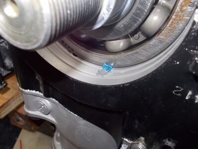

Credit to Christian Morris for discovering the easiest method for applying the epoxy.
When filling the second hole for the rear seal in crankcase, I have found tapping it first to be the best route to go to provide mechanical interference for the epoxy to bite into
