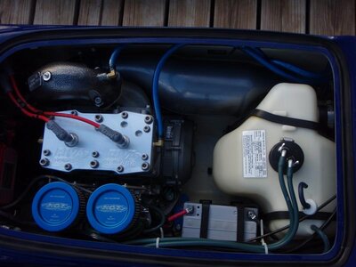

I had some of those molded oil tank vent tubes laying around ao I used one of those on top of my check valve.
It has been working great so far, only thing is the hood has been catching when I go to hook it in. I keep it tucked under the fuel lines exiting the pickup now.
