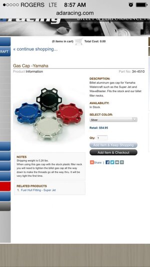

Anyone here ever installed aftermarket gas cap and filler neck on a 2014 super jet. I just looked at my stock set up and noticed that there are no screws on the exterior of the filler neck that mount it to the hull as there always has been on Older superjets. It looks as though maybe they just glued the filler neck to the hull?

Hmm.. Maybe that will work but idk. I'm pretty sure 2014 necks are different because the caps are. Caps are now clicker style like on cars. They don't tighten to a stop they just keep clicking
I had to thread mine all the way through for it to work right just as it says. The first few times I diddn't do it. That is probably all you have to do.

That's what you did in your 2014 super jets or older? To hell if you can do that with mine. There's about 2 and a half threads in the filler neck. You run out of threads... Can't go any tighter there's nothing to thread to lol you'd just strip it if you even could turn it. I am twisting as hard as I can with two hands on this. Billet neck is definitely required... This isn't a usual oem filler neck. They changed them

That's really weird... No way does mine have enough threads to sink the cap that deep. It's a good 3/8" from hitting rubber gasket and its out of threads. I ordered the billet neck, screw it
