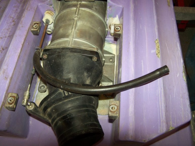

In preparation for the 08 season, a inspection of the pump revealed a reduction nozzle issue... some Broken vanes. Hmmmm???, I had this blaster nozzle laying around for a replacement.
After riding WaveHog's and Special FX's ski's with the adjustable trim setup (which is really cool) it is time to give this a shot on the 144mm. Using a Kawi X2 Trim/steering nozzle arrangement, it amazingly fits perfect on the Yamaha/Blaster max flow Pro-Tec nozzle.

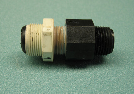

Since the Trim ring sets back the cable attach point about 1", I found a sprinkler riser extension worked out as well as a cable end extension. New heim joint ends eliminate all excess steering slop.
One thing I did notice is that the stock Yamaha 144mm reduction nozzle used 2,1mm shims between the ears and the hull. The Pro-tec Blaster nozzle need 4,1mm shims to do the same job.??

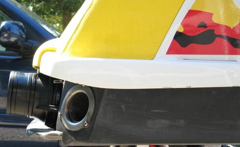

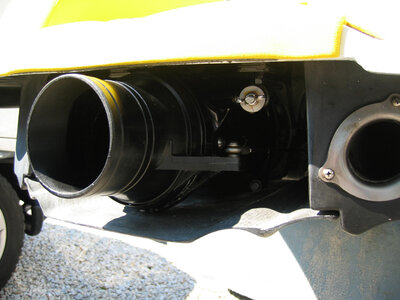

Ok...so here's the low-down on fine tuning the FX-1 pump conversion (650 Kawi OR 144mm Yamaha). After much testing (trial & much error), resolving the goofy handling issues has come down to this. The Kawi X-2 nozzle with trim must be used in order to get your boat to be ridable. The standard nozzle setup creates too much downward thrust that creates a high speed instability. (A weird nose down chine walk). You guys like to ride fast at times...don't you?
Another problem...the steering cable is too short to fit. Since the trim ring moves the steering nozzle about 1" back, you"ll need a cable extension. Either make a cable end extension, or move the whole cable back like I did (see the 1/2" riser pic in above post...BTW...use a PVC one, the marlex one breaks).
I ride around with the nozzle trimmed up part way most of the time (See pix below). Sorry for the ride/handling report delay...it took some time to get the details worked out.
Thanks goes out to Special-FX for the X-2 nozzle donation for EXPERIMENTATION.
Hang on! The FX-1 pump mod is well worth the effort!

I had the same issue with the first one I did, I thought I didnt get the pump angle correct with the firewall, turned out everything is in perfect alignment
I solved the issue by using a protec blaster nozzle and a yam Raider trim ring and reduction nozzle
It kept the nozzle form sticking out so far I did have to make a 1 inch steering cable extension though
as far as adjustment goes you can see the pics of how I did it
I use it as a Fixed trim by adjusting the nut on the back of the tray, For surf riding it takes a substantial amount of up thrust to keep from subbing

So you guys have it set up with no cables and levers? I was wanting to do that but couldn't figure out how. How do they ride just cruis'n around? Alot of cavatation?
No cables and or levers, just a simple adjustable nozzle. The stock angle that is "pre-set" at yamaha might be good for a stock SJ, but it has too much down for my FX. (a high speed handfull). I like to have the nozzle cranked up a little...higher than stock for high speed, lower it down in the surf. It works great.

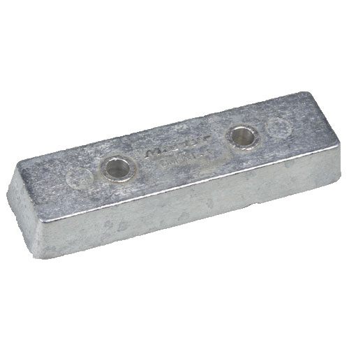

Here's a good example of galvanic corrosion on a Skat Trak mag pump. The stainless insert is still like new, but the OEM housing dissolves away. This is round #2 for this pump. I fresh water wash my ski every time and spray it down with Dupont teflon silicone spray. AND added a strip of chemically pure zinc metal (for plating) to the side of the housing. Nope, that didn't help much either. Salt water gets between the 2 metals and acts like a battery. Fun to play in but doesn't play well with our toys...
