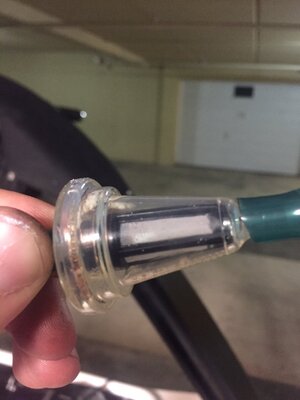

Replaced inline fuel filter on one side, had some garbage built up in it, but not in the actual filter, it was in the bottom of the filter where the fuel sits. See attached photo. Can't get it to move around in the filter.image1.JPG image3.JPG

Could it be fuel selector switch? Starving enough fuel so it won't crank? I pulled carb apart, was a little grimy, but not bad and the conical filter was almost completely clean. Its all cleaned and back together, no improvement.

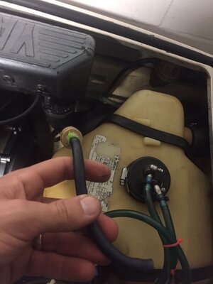

Should I be able to blow through the vent line either way? It seemed to be totally clogged (pulled from the tank and tried to blow through it). Internal filter on carb completely clean. I pulled the vent line and tried to start, but still wouldn't turn over.

The vent should allow air to go into the tank but not out. They do fail in a manner you described, getting stuck closed. From my experience, when this happens, the engine will run fine for a few minutes and then just suddenly die down.
