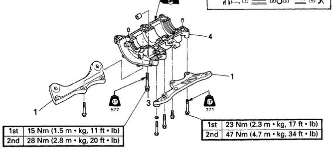

I am having a hard time reading the case bolt torque specs for a 701. It appears there are 8 bolts, but there are 2 sets of torque call outs depending what bolt (or bolts) are being designated, and it's confusing.
Which bolts should be torqued to 11 ft lbs and then to 20 ft lbs, and which ones should be torqued to 17 ft lbs and then 34 ft lbs?
