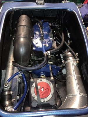

Besides the trusty B pipe... will a Laydown or dry pipe fit? Looking at re-using the old EME superjet exhaust, it uses the factory dry pipe manifold.

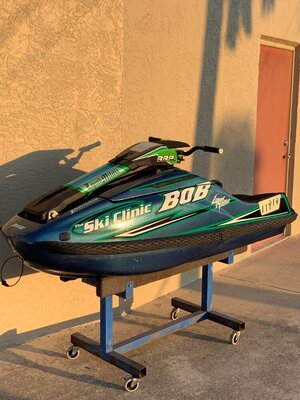

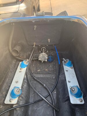

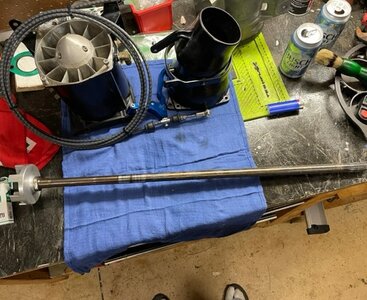

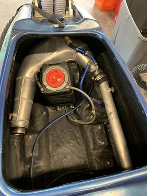

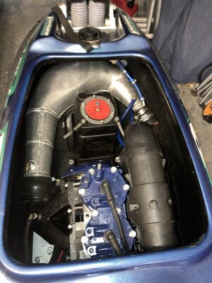

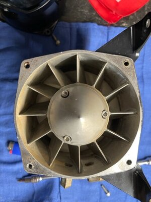

EME exhaust fits. It's tight. ski is at my buddy's place for the next month til I go on vacation. He gutted it for me, sent in the order to JM, got a steer and throttle cable, gasket rebuild Kit for the 62t and 38s. Pump is a Kawi 140 with a 9/? impeller. Buddy FaceTimed me we think it's a 9/17 but the marking on it's faded. It's got 2 extra tubes that have been plugged, so I'll be running trim down the road. The resonator tube is probably going to get cut and split up to accommodate the battery box, or just relocate it. The pole thru hull tubes need to get trimmed up since they're a little too long, everything will fit much better afterwards. Stoked to hear this thing brap
That looks like a very early Power Factor Pipe.........
came out of my signature series that nobody wanted to buy

loosing my mind! Saw EME and had WDK stuck in my head!!!!!!! Either way, that is one of the Early Power Factors!!!!!
Significant difference between this thing and a B pipe, that's for sure. I sold it to a friend last year on the condition I bought it back. My buddy is resealing my 62t for me and doing carbs, then just waiting on the rhaas kit and seeing if we need to relocate the battery, or to what extent. It should be ready to go within a week or so of getting the rhaas kit.

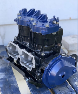

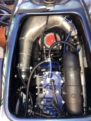

stock 62t all freshened up today thanks to my buddy. Electrical is getting all bright green wire loom, carbs are nearly done, tomorrow (Monday) all the remaining stuff is delivered
snagged a good deal on a skat mag setback 142 off the P... in a few paychecks I'll probably secure myself an MSD enhancer, head, and probably send off the flywheel for lightening / drilling. For now it should be a fun ride... believe it or not, this was on the same EME that the exhaust came from. Funny how that works :D
