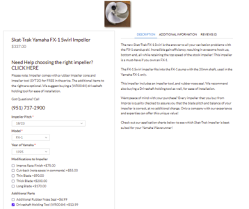

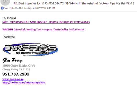

BEST IMPELLER for a 1995 Yamaha FX-1 61x 701 engine with a single SBN44 carb with the original Factory Pipe made for the FX-1 ?
E350
Sacramento Delta
What is the BEST IMPELLER for a 1995 Yamaha FX-1 61x 701 engine with a single SBN44 carb with the original Factory Pipe made for the FX-1 ?
And what is the best impeller removal/installation tool/socket for this purpose?

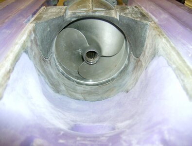

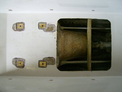

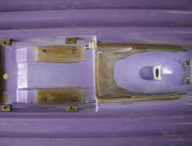

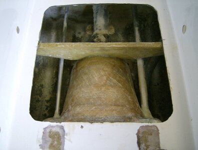

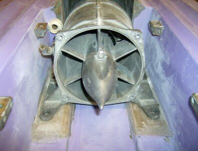

The pics I posted are of the 650/X2 pump conversion. The green is what you’ll be grinding to make it fit. While you can do it without cutting open the tray , it’s usually best to open the tray, replace the water logged foam, the rotted water lines etc. , and build up the thickness of the pump tunnel prior to grinding to fit the pump.
