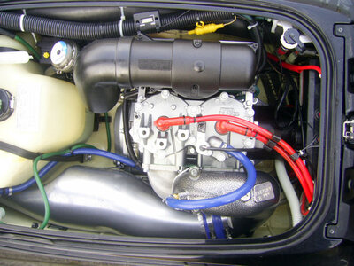

Would that intake setup be the best for freestyle?
Apparently lots of guys are going to stock airboxes because they don't let water in like the AM ones. It makes sense to me because of the shape but is there a performance loss using stock vs aftermarket?

rue the cool factor but when you fry a very expensive engine cause i breathed in alot of wter, you have a really cool looking paperweight that costs alot of $ to fix. I learned the hard way!

That's the only reason people buy AM arrestors IMO. The stock ones keep water out, and don't break up and get sucked into your intake - what's not to love? As far as I can tell AM arrestors are all negative apart from the bling factor.

I have run K&N Pro Series cones with no outerwears for several years. Got 3-4 years on last set. If your getting that much water into your carbs then your hood system is not sealing good or you do not have a fast enough evacuation system for the bilge water.
