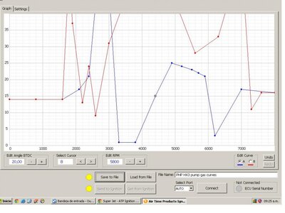

Hello, I have a hx3 epic but with this program I can not access the curves, I can only read the serial number.
my question is if this program is right. anyone can help me?
if not the program, I could send x email which should I use? -> Diego.galliano@gmail.com
Thank you ...

It appears connected and reads the serial number so is it possible that is the current curve?
Try loading a new curve "from file" so the screen shows a proper curve then hit "get from ignition" to see if it writes it back to a flat line.
hi, yes, I did that.
but when I read the curves from the epic, the graph appears unchanged. or with the same curves that are not epic.
therefore, I think the program I'm using is for the flame.

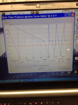

WTF...... So you can connect to the HX and view it's curve ok ?
But when you use the editor on your computer is corrupts the curves your trying to draw within the computer ?
What software are you running, Vista 7, XP ?
Sounds like the editor, or computer or operating system is corrupt
Try to email Airtime again and go over it with them, maybe have them resend the down load link and save it to a different computer with XP or 7 on it,
XP professional works fine for me
Your at VO.0.9 or something older
I know you said you tried emailing them, they've switch to straight email communications now no more PM's
You buy this stuff from Airtime
Edit: I was able to draw a waked out curve like yours but not to the point where I could get it to go off the top of page like yours above 40 degrees

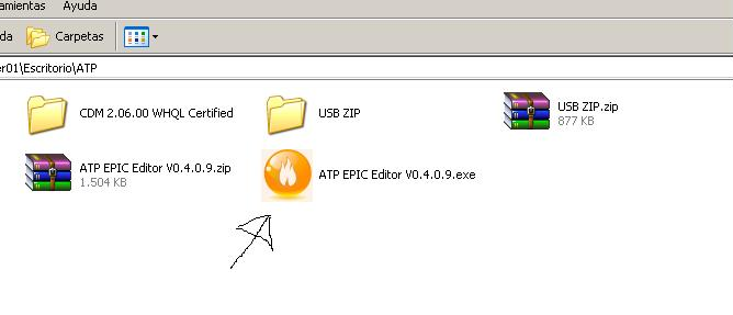

The other thing ATP 2010 at the top
But I see that's the file date and name, is that your newest version
