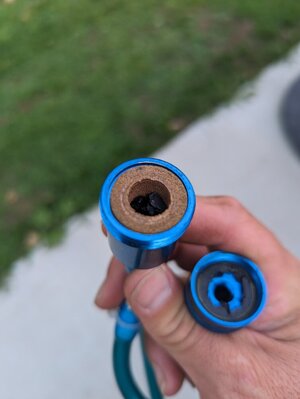

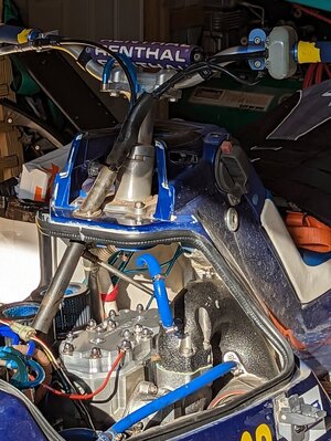

I ordered rebuild kits from Sudco. If I open the the bottom any more than it is the ski just dies.
