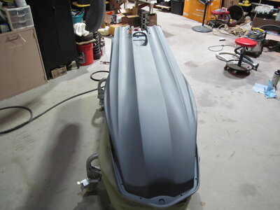

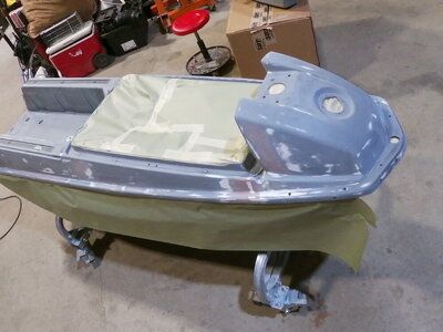

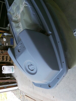

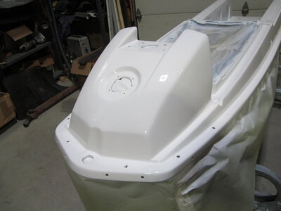

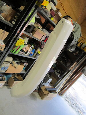

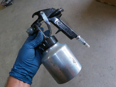

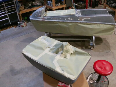

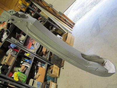

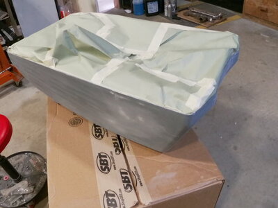

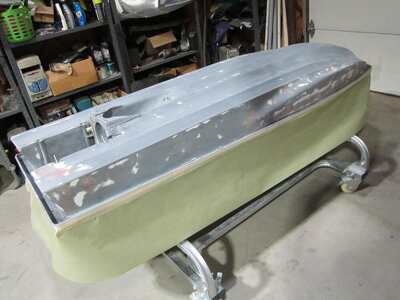

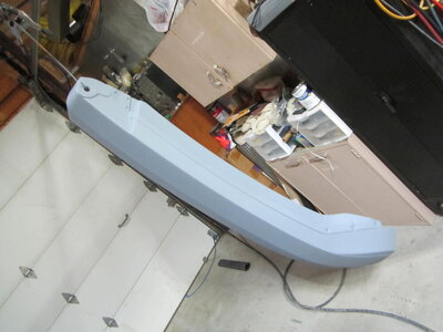

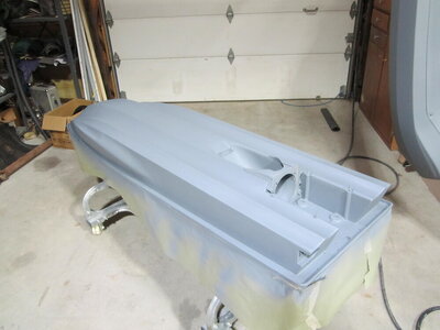

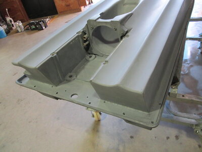

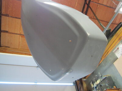

The rain finally quit and I got a window of low(ish) humidity to reprime this bad boy! So I cleaned out my trusty old primer gun, masked off the topside and hood, and recoated!
Myself
manic mechanic
Twin Lakes AR

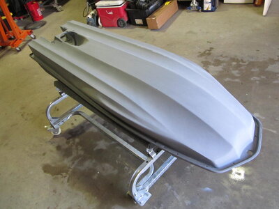

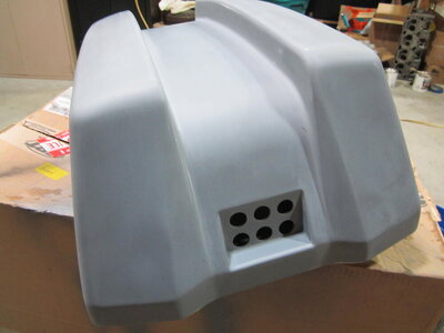

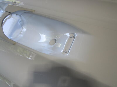

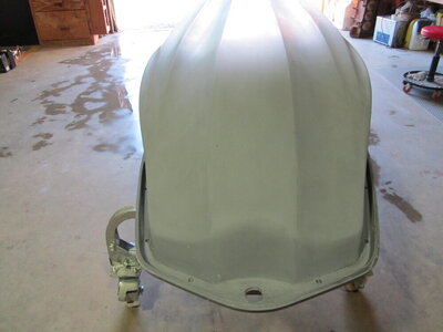

And the primer laid out real nice! Just look at those smooth body lines!

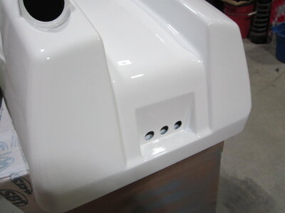

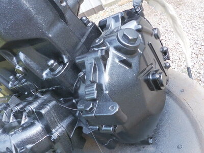

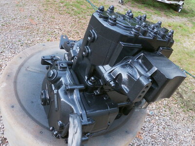

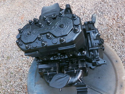

And then while I was letting my shop air out, I scuffed, primed, and painted the engine.......OH YEAHhhhhh!

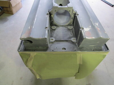

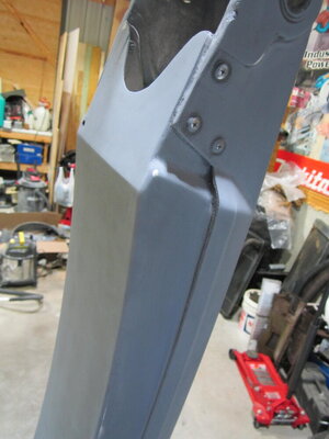

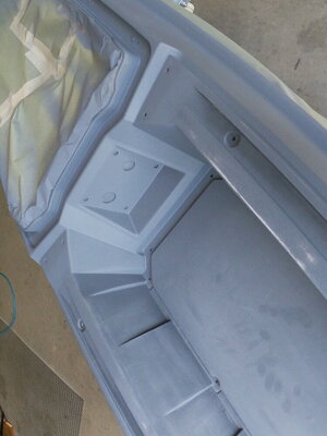

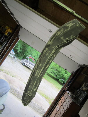

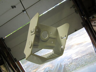

I worked overtime on other customer stuff the last 2 evenings and today until 2pm. But after that I got the bottom side and handle pole touched up and finished out, ready for 2nd primer coat.

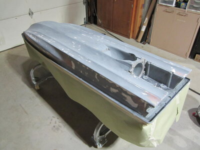

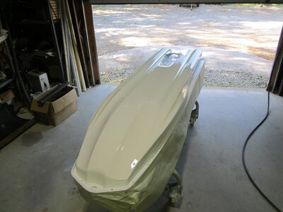

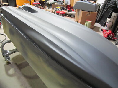

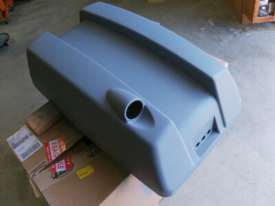

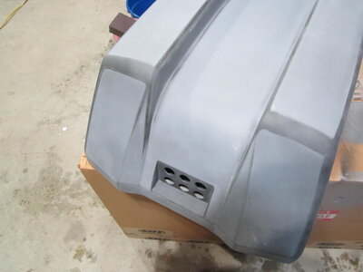

I was able to get 2 good coats of primer on today. Everything looks good. I'm going to try and get it wet sanded with soft blocks this week and maybe paint next weekend!! MAN........just look at those smooth lines on those molded in sponsons!! Not too shabby if I do say so myself :);).

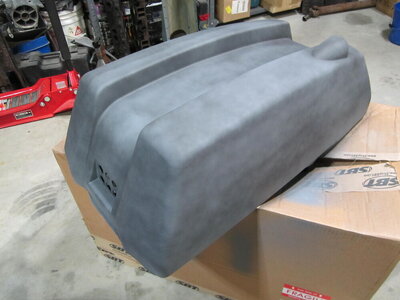

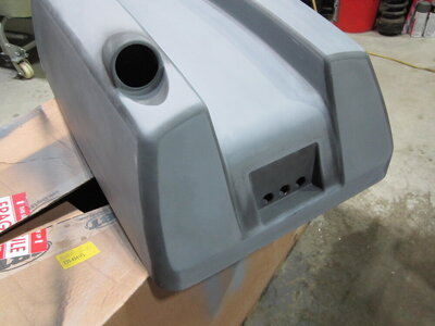

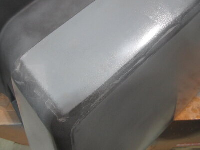

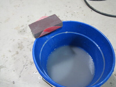

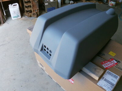

Well, it was lightly raining half the day so I sprayed on some guide coat and started soft block wet sanding with 400 grit. The panels should all be FLAT from previous work. This time around we are trying to just knock the guide coat off while leaving ALL (or almost all) of the grey primer. Just smoothing things out. A bucket of water and a spongy sanding pad is what I prefer. It should be pretty easy to knock the primer down smooth without a lot of pressure.

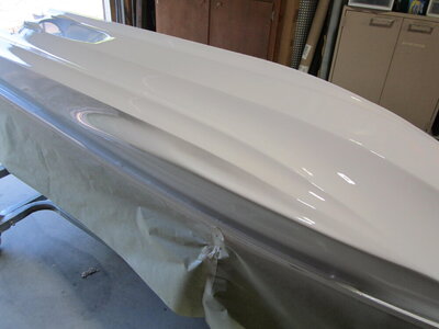

I like to hit all the large areas first while staying OFF body lines and corners. When this is done it should look totally like a RAD 70's panel paint job.

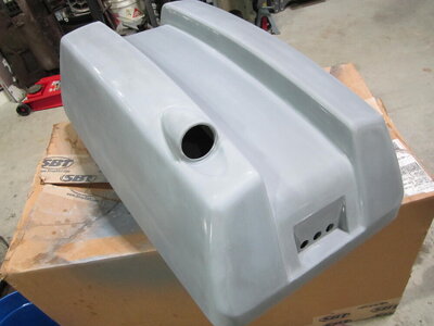

Then CAREFULLY go over corners with a long crosshatch motion. Then anything else using fingers or any other tool that fits the surface...........TADA!! Hood ready for sealer and paint.

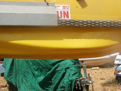

Hmmm I wonder , I have been rodeoing for a while now.

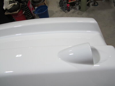

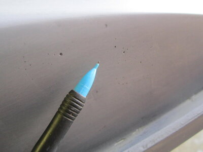

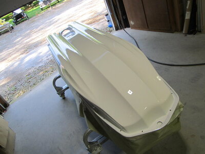

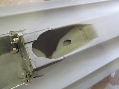

I had water testing on skis to do every night this week after work so I wasn't ready for paint this weekend. I finished up all the 400 wet blockout today. After a good washdown and inspection I found some pinholes in the fairing fill I had to touch up....no big deal. Any large project like this will need little spot fills here and there before paint. Anybody that says otherwise is a LIAR! Anyhow, looking great now and I'm looking for a low humidity window to get paint down.
