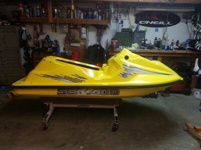

Looks good, my 2008 was in the same bad shape. Went through the whole thing top to bottom. Only way to to it when theybare that way. Your paint came out way better than mine. Probably better quality n definitely better body work.
Thanks. For the paint I really didn't spend that much and was my first real paint job. I am convinced Southern Polyurethanes Universal clear can make anyone look like a hero, that stuff wend down so smooth and flowed out so good I was shocked.
