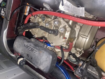

One is poking the long exhaust tube and the other two I’ll be filling them in from the inside out, eventually I’ll be running my normal setup with two into the tray to keep my feet warm. Pump mounted right up and the cooling is done on the motor. Only issue I had was the steering cable has an aftermarket nozzle style end for the steering nozzle and that ain’t going to work with the stock nozzle haha

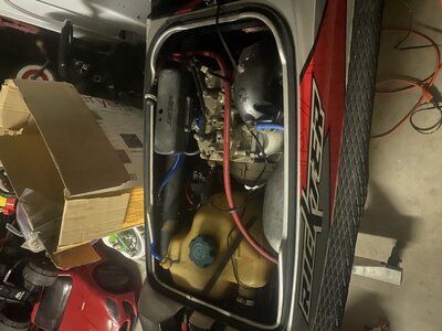

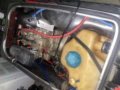

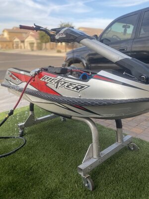

Update: picked up the midshaft today, it was ready to bolt up streight from Jet Action. My old boss is always helping out where he can and it has made me stoked to rep his shop for as long as I’ve known him. He’s always down to make sure I can stay on the water ripping instead of wrenching. Ended up learning quite some about how important the rickter mounts are for getting the motor far back enough to work with a fully pressed in SJ shaft. With that being said I am using couch mounts haha so I made it work and for myself a snug midshaft alignment.
Once I had the midshaft in and where I wanted it, the motor was secured down. I had all the gaskets sitting around ready for the b-pipe and carb. Got the water box back in, all the exhaust hoses secured and this time I have all the cooling lines plumbed. Pump is actually in the ski now but unfortunately I can’t find my pump seal...

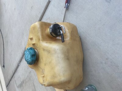

Pretty much I slammed the ski together, did another test fire, and then made a note of the small stuff necessary to feel confident taking it out. Simply need a pump seal, throttle cable adapter for Kawi to Yamaha, and to replace the fuel tan strap that broke as I was putting the tank in.

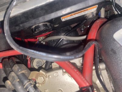

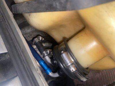

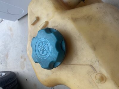

here is some pictures of the tank situation I’ve provided a solution for and pics of the ski all together!

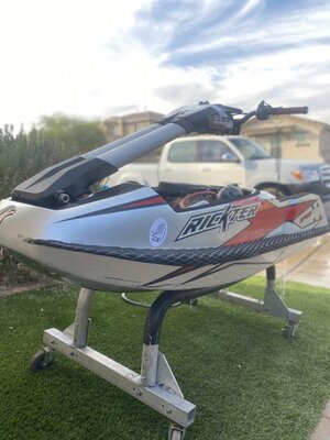

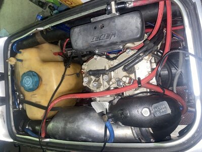

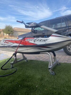

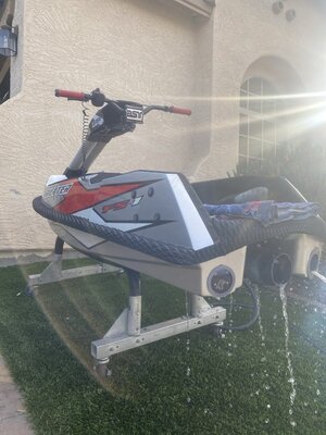

Last 3 items I needed are on! Check valve, throttle cable adapter, and block off plate. Now I need to drill a hole in the dash for my quick disconnect flush setup and I’ll be money!
Here’s some beauty’s, still have to bolt the rideplate on, take the pump out to put a new pump seal on, and then put it in lake havasu this weekend

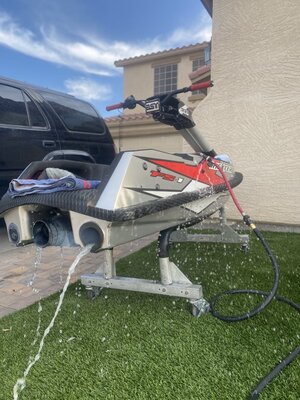

Little video of it running on the hose with the pictures from my GoPro hero 8 black. The GoPro makes it to easy for me to pull video off and make an edit so I just can’t help myself. Threw some music on it and otherwise it’s nothing too exciting just the ski running on the hose.
I love the Yamaha quick disconnect flush setup, and I always run my skis on the hose after building them. It pretty much just lets me know the water is moving, make sure the engine runs at a good temp, and to ensure none of my hoses are leaking into the hull.
Everything was bone dry the whole time after running it on the hose for about 15 min. Best part about the fact it checks out on the hose is that putting it into the water never fails to be a different story haha. Couldn’t tell you how many times my ski that was dialed before I headed out to the lake, ended up needing some love on the beach to ride. This ski should be just fine, I’m about 90% confident in it and the other 10% assurance is a whole ski worth of spare parts I’ll bring to water test lul. Can’t wait to see some friends out in havasu, and possibly get to ride body beach for my first time and on a rickter at that. Stoke level is Maxxed out!!!
