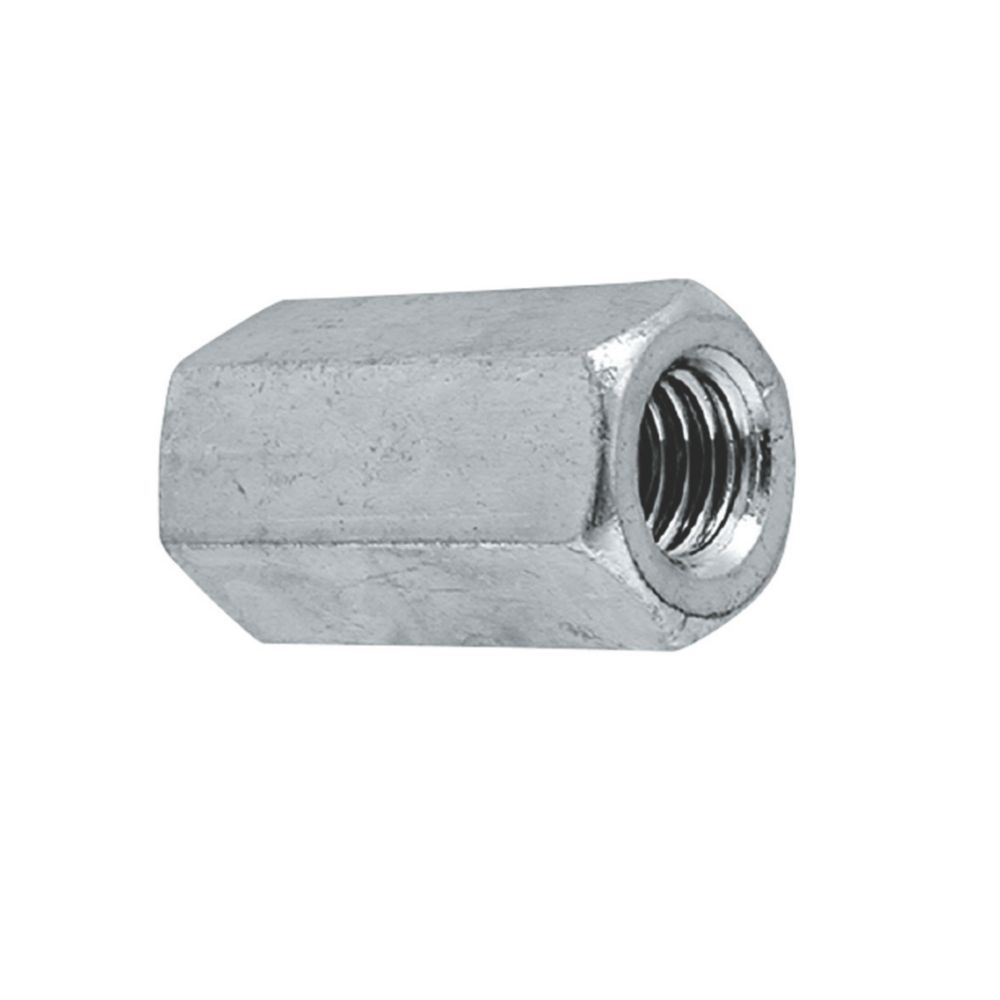

What about a two piece half length stud connected together by these?
What would be the advantage. Im just getting a price to make these now. We are trying to move into the freeride super-jet market
