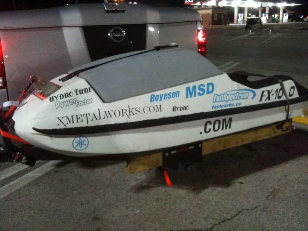

I bought a FX-1 hull with the big pump mod to seriously chop up, but in the middle of my research this ski was offered to me. Better to have the work done, and feel confidant that the work is better than I can do at a novice level.
I picked up SuperJetBrett's "Raped FX1000" hull, minus the 1000 LOL...
Here is the build thread if your curious on the history.
http://www.x-h2o.com/threads/74328-...now-getting-xs1000)/page1&highlight=raped+fx1
Basically a FX1 Chopped and re-rockered nose, shortened rear.
SJ pump tunnel and SJ pump mounting area grafted into FX1 hull.
Lowered and reshaped Gunwales.
Footholds
Xmetal Scupper
Reinforced sidewalls
Jetmaniac hood straps
Pole mount moved forward 4"
I'll be adding Tom21 Sponsons.

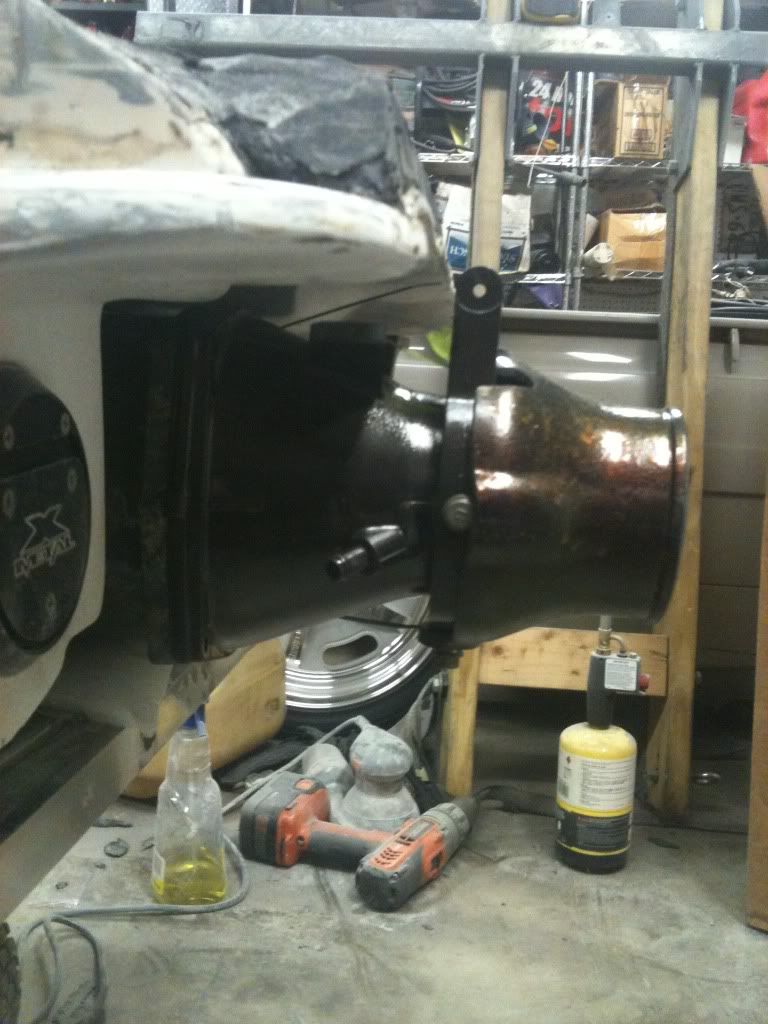

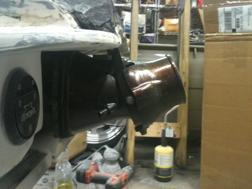

CATS setup, i've 'clearanced' the trim ring and the reduction nozzle to get mor throw.

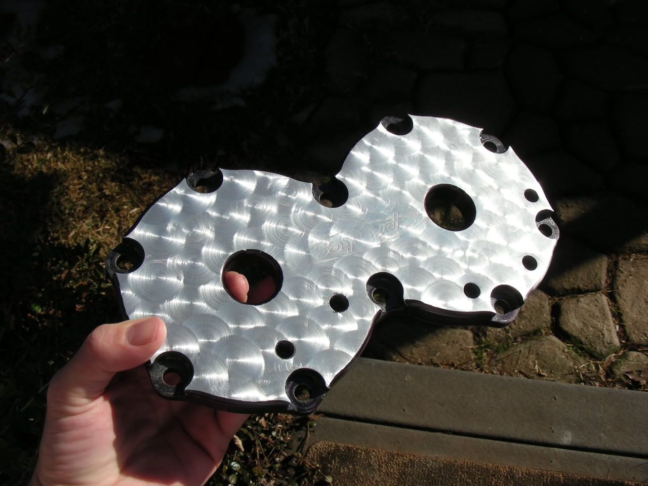

I bought a first gen Protec head. The anodized part didn't look great so I gave it the hot rod treatment. Its not the best work i've done, but the anodizing was super hard to cut through. I dig it, it'll look sweet when I pop the hood.
swapmeet
Brotastic
Arlington TX
Harbor Freight has mini roll lock discs. I chucked an abrasive disc in my drill press. Little cutting oil and some patience and you've got it.
The top of the head had a texture cut into it, likely to help hold the anodizing. It made it really hard to get good consistent cuts with the disc.

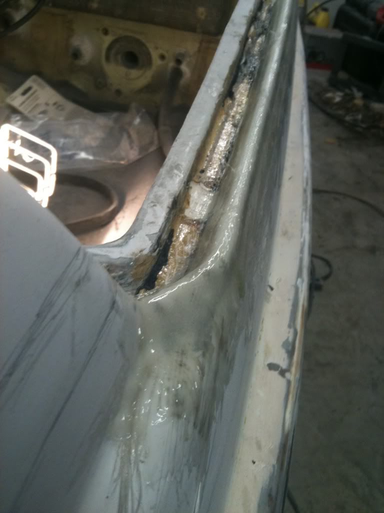

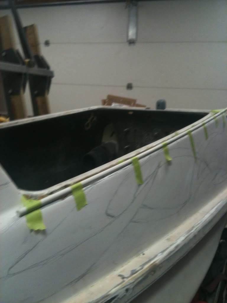

Was able to talk with a seasoned vet about a chronic problem with the FX1. Dislodged hoods on failed rolls. Since I was already in a rough glass stage with the ski, I had an idea. I super glued 1/4" fiberglass rods to the outside edges of the hood seal. The super glue holds the glass in place. Using Epoxy resin with Cabosil, I filled the gaps between the hull and glass rod. Then I cut a strip of fiberglass and layed it over the whole shabang. I'm a little concerned that I didn't use a long enoug piece of glass. But all I had was 12oz on hand, so hopefully that does the trick. (feel free to chime in on that)
I cut about an inch off the end and curved it towards the nose. I'll body work it to make it flow. This should make it much more difficult for the hood to completely come off, even if its dislodged. Intrested in your thoughts on this as well.

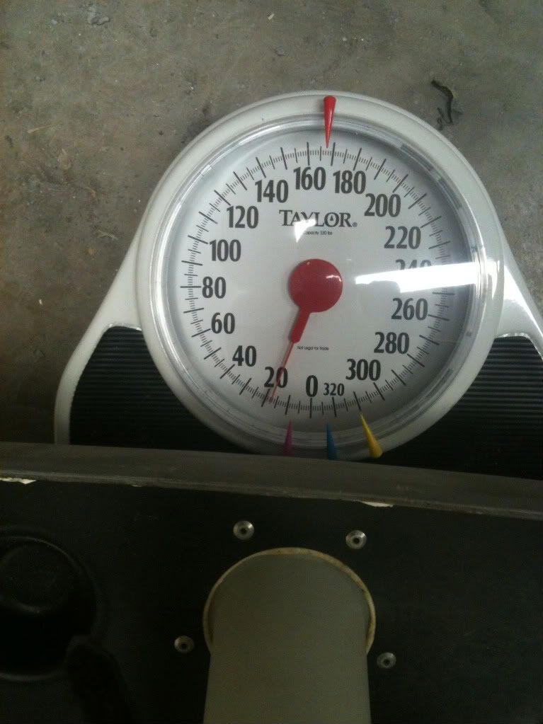

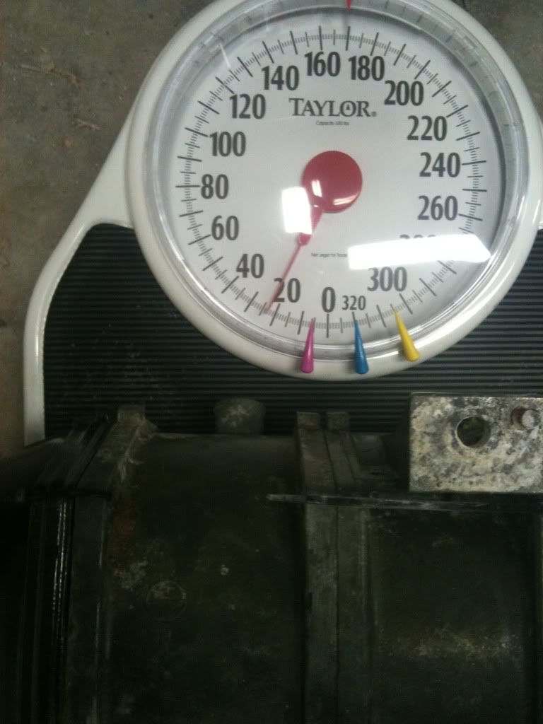

I bought a scale, probably a bad idea. Last night I weighed the hood and the pump. I can see why people buy aftermarket lightweight hulls!!!
I'm scared to put the entire hull on the scale, but i'll do it sometime this weekend.
Hood
Pump
