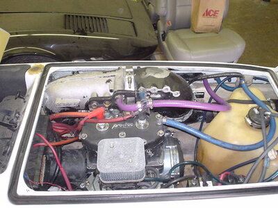

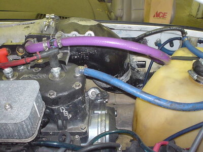

I have one in a SN that I built mainly from scrap parts. It runs pretty good, but could probably be better with some tuning.
Here are a couple pics of it.
Aaron

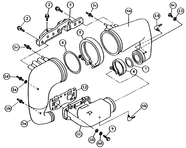

What are the basic parts of the WET JET pipe? The pipe comes in 3 pieces (plus harware, gaskets, crush washers, a bracket, etc). The 3 main pieces are the manifold, the head pipe, and the tail cone.
Can I bolt it straight into my SuperJet or Blaster? NO. I have no experience installing it in a Blaster, but I did put one in a SN Superjet. The tailcone has to be cut and rotated so that the exit points towards the stock water box.
What kind of pipe is it? I've seen it called a wet pipe and a dry pipe. More on that in a minute.
What about water routing? In the pictures it looks like it has 42 water fittings/holes.
Most of the holes are for the mounting bracket that secures the HEAVY pipe to the stock cylinder head. I cut and modified my bracket so it works with my Protec Recreational head.

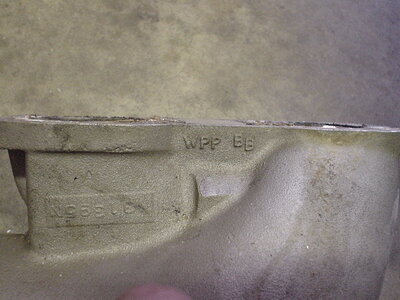

Looking at individual parts -
1. The manifold is pretty simple, but due to an odd casting it doesn't use all the bolts. Seems to be leak free on my ski though. It is set up for single cooling. I'm not sure how easy it would be to add another cooling inlet line.
Here is a pic of the complete pipe and a close up of some text on the exhaust manifold.
Aaron

A couple of tips:
1. Keep the bracket (part 3 in diagram). This thing is held together with two large clamps (parts 5 and 8). The pipe vibrates enough that it will rotate. The bracket was apparently designed to eliminate this problem.
2. There should be copper crush washers (parts 4 and 7) between the joints. This keeps the exhaust on the inside ;-)
3. Grind off some of the casting on the top of the head pipe. Check my installed pics and notice how it's barely touching the hull. You can avoid this with a little grinding.

I forgot one more installation tip. I had to flip one of my e-box mounting brackets over and modify the other. I moved the E-box towards the right side of the ski (when standing in the tray).
Also I am only using half of the Wet Jet bracket. It's enough to reduce vibration. By cutting off the part of the bracket that attached to the tail cone I was able to rotate the tail cone to a more favorable position to meet up with the Superjet water box/clear the tank/and enough room between the hull and stinger nozzle.

I had mine out of the ski tonight. I should have taken pictures. I noticed that I did grind on the cylinder some in the bolt areas above the exhaust manifold flange (I think a stock exhaust bracket bolts there). I did that so that I could rotate the pipe as close to the cylinder as possible to increase hull clearance.
Aaron

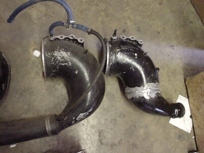

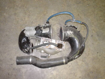

Also these pipes can have different inside diameters. The Kraze pipe I have, while looking to be identical from the outside, have slightly larger chambers inside. I have both types I will post pics.
I've noticed that there are two different colors, one is blue and one is black. Which one is which?
