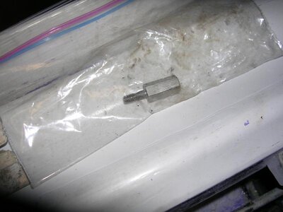

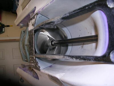

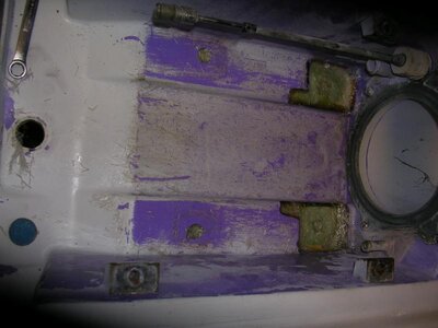

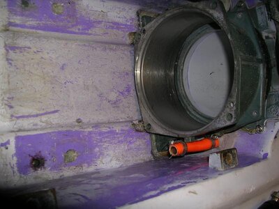

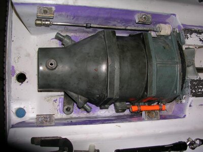

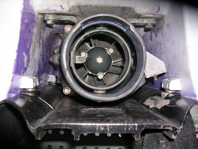

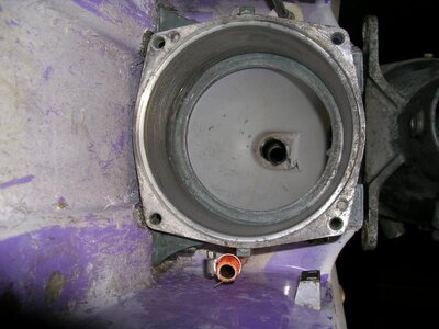

I lowered the area for the front mounts (lowered meaning the ski was upside-down and I cut into the hull) 10mm. When I ground that far down the very front, outside corners got real thin and even broke into the foam/void underneath so I mixed up a some chopped strand and really filled in all in well, did a little sanding to get it all nice and smooth again and used more chopped strand to fill in all 4 mounting holes. On the front areas where you grind down you also have to clearance the edge of the mounting surface towards the rear of the mount to clear the flange on the pump (as seen in the pics) slide the pump assembly in and mark for the rear mounting holes, and drill them out. The stock FX1 pump to hull hardware is smaller than the SJ ones so in front I used SJ sized bolts with the heads countersunk into the tray this holds the wear ring section to the hull much tighter and makes it easier to line up. For the rears I cut rectangle recesses into the tray to hold the stock FX1 "nuts" then glassed those in. This is less than desirable for most because if you ever want to remove the wear ring you have to remove the turf, you could use sleeves on the stock FX1 bolts to make alignment easier then use the same method I used in the back to eliminate the problem...I decided to go the easy way since whenever I pull a pump I remove the 2 rear mounting bolts and the 4 long bolts holding it all together and leave the wear ring in, making it easier to re-install and not fight with getting the pump seal pressed in tight.
Due to the FX1 having its thru-hull cooling fitting on the opposite side I pulled the dowel pins out of the stator section and just flipped it 180*. Hammered the blaster driveshaft out, pressed the FX1 driveshaft back in its place.

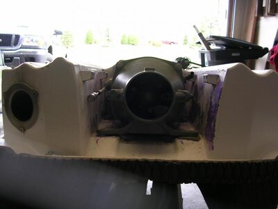

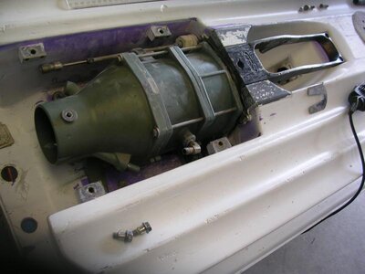

The stock pump shoe is much smaller in diameter than the 144 pump, I opted not to do all the work to chop my hull up and put in a 144 pump shoe and just went the easy way out. I was told you could easily open the stock shoe up to 130mm so I just spent some time with the dremel and opened it up as best I could while keeping it smooth and uniform....later I would use silicone to ramp the back of the shoe down to the wear ring, reducing the air pocket in that area and cutting down on cavitation. It is not "optimal" but after testing it seemed to work pretty damn well.
For the steering cable you have 2 options, protec steering cable extender, quick and easy just screws on. Or a PVC irrigation fitting that is the same size as the through hull fitting for the cable, not sure how it works if you do a search Wave Chaser did it this way.
For the turn nozzle you have 2 options, due to bottom mounted steering position on the stock nozzle it sits pretty much exactly where the rideplate will sit and that is a problem. The protec nozzle has a mid-mounted steering arm that works well, I am cheap and so I cut of the stock arm and made up a quick piece of angled aluminum, drilled a hole for the steering pivot and bolted it to the nozzle with 2 button head cap screws...this was just a quick and dirty till I can afford a protec nozzle but it seems to work very well (not sure on how well it will hold up though).
Also the steering cable will then hit the stock outlet for the yamaha pisser fitting on the reduction nozzle, I just cut mine down.
To make it all line up right I had to add 4mm of shims at the rear pump mounts. Once it was all in I had to address the rideplate problem.
The pump area on the FX1 is frankly just not big enough for this pump and my rideplate was not even close to fitting (DG finned plate) I had to use a grinder and clearance the plate where the rib between the stator and wear ring sat, had to nearly grind through the plate to get that to fit, not wanting to totally butcher the plate and compromise its integrity I decided to add 2 washers at each plate mount to space it down...it sits nearly on the pump but barely (if at all) sits below the bottom hull surface and seems to fit fairly well. (ignore the dirty ass hull, the stray fiberglass strands and crappy paint, it is the beginning of riding season here I just want to get on the water, I will clean it up over winter.
