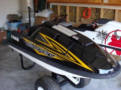

Got my front sponsons installed this weekend and the RRP pole bracket. Getting prepped for the big assembly next weekend.
It's going to be so hard to take pics as I go, I'm gonna want to just keep going.

This weekend I got my new carbs set up and installed finally. I swapped out the orange fuel lines for yellow, pulled the engine to trim the bedplate for more pipe chamber clearance and spent a little more time on engine shimming. I also finished up a few other loose ends like primer knob and battery connect for the bilge pumps.
