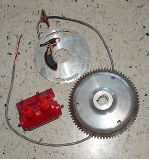

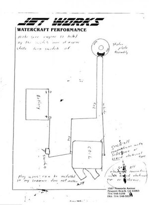

Here's another one.....

:scratchchin: Interesting; are there any old systems with a set of points and a condenser coil. :crazy:
not that I'm aware off, but with enough tinkering, you might be able set one up that way. most of those type of setups are on 4-stroke configurations, i/e, a lawnmower, certain cars engines, etc...

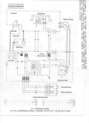

it is the kv set up but i removed the stop module and replaced it w/ a bosch relay. is the stock rev limit in the coil pack or that module?
there is no rev limiter built into the coils.
as far as the module goes, it's just a relay telling the coil when to fire. no rev limter.
that "auto cut-off" switch in the KV setup is just a relay to kill the engine when you press the putton, so you don't have to hold the button down until the engine stops.
