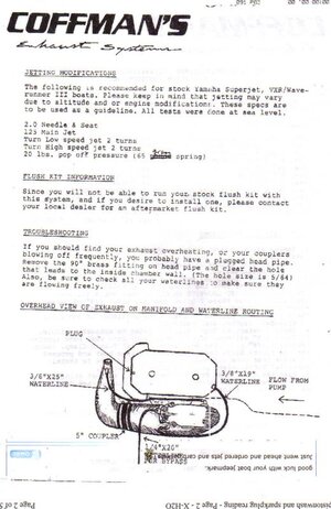

accbr your pics are not up in your thread anymore. Thanks for posting the directions.... I just got a protec head with two cooling fittings on it. Any idea how I show run the lines with that and the pipe? I am going to look at the pipe now to see how many fittings are on it.

I just posted the cooling line pic like vitalikol did. I'd just post them like the pics in the thread Mouth posted if you have two outlets on the head.

I checked the setups and I understand how to run the lines I am just wondering what to do with the other cooling port on the head. Should I just run it straight to a pisser?
I have also had a few questions about cooling line routing running this pipe and a head with two fittings. But my sizzler pipe only has two fittings on the head pipe? I have seen a few pics of others on here like yours that have three fittings on the headpipe. What's up with my pipe? I guess coffman changed up the design at some point?

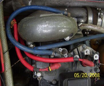

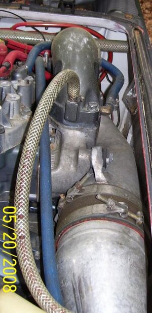

I snapped some pics of mine a few days ago.
its DIRTY, but you can see the hose routing.
