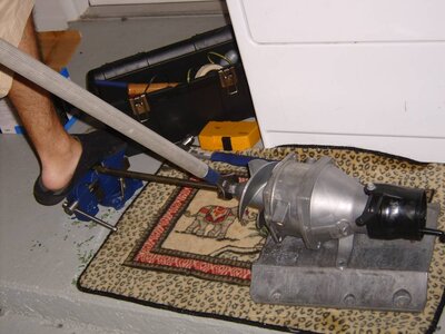

I was finally able to remove the impeller. Here is how I did it...
I removed a big bar from the closet and I stuck the cresent wrench inside one end. The impeller got loose right away without effort !

very good young grashoppa. that worked out pretty well huh :cool2:
