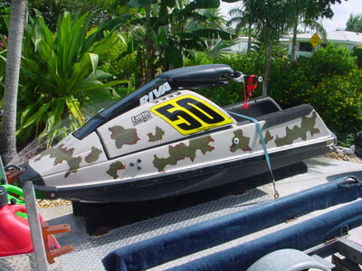

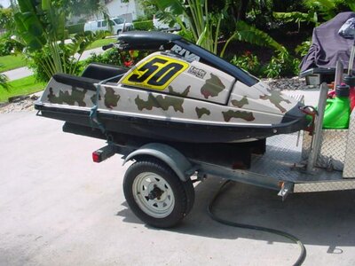

i used that car touch up paint in a can they sell at walmart to paint part of my pole, it looks good dont know how well it will hold up though they make a clear coat too. I think it was duplicolor...
thrllskr
Converted Coucher
Hoboken, NJ
I used Duplicolor on my X2. Seems to be holding up ok but it doesn't have the gloss I wish it did. And I clearcoated it. Total cost about $40!
Dude, that's cool looking though. Looks like a Mad Max or Water World machine... I like it...
