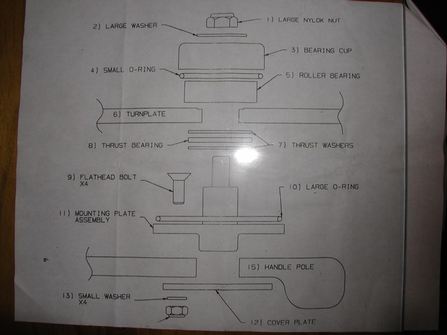

UMI Steering part numbers, UMI rebuild kit, UMI Instructions
SuperJet:
Spindle Assembly Srews:
4 - Metric socket flat head machine screws - M6 x 1.0 x 21mm (not 100% on the length, but I think that is what I measured)
Thrust washer:
Size 7/8" x 1-7/16" x 5/64" (bore x od x thickness)
NTA 1423 - Qty 1 - Thrust Washer (5909K34)
Size 7/8" x 1-7/16" x x .030-.032
TRA 1423 - Qty 2 - Races
Bearings:
Bore 20MM, OD 42MM, WIDTH 12MM
6004-2RS (6661K87)
O-Rings:
DASH No's: 131 & 146 (& 113 for newer models)
Installation
UMI assembly illustration attached, and can be printed from instructions PDF.
If you still have problems view this thread: UMI Steering on 96+ SJ
When in a bind go to any bearing supply company and they should have what you need, otherwise support the companies involved in the sport and save yourself the hassel by buying a rebuild kit from Blowsion or Jet Ski Solutions (ckeck out JSS "Tuff Thrust" solution for the Thrust washer).
