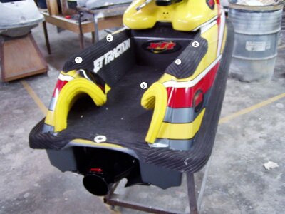

You must make 5 holes in your hull, one in the deck over the shaft tube/hose and 02 in each top side.
1) Put the hull with the nose up and put the foam in the holes "1" and when starts to expand and before starts to drop out close there whit a PVC tape.
2) With the hull in the same position put foam in the holes "2" and close with PVC tape.
3) With the hull in the horizontal position fill the "3" hole.
