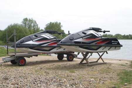

We were asked to build two freestyle skis for a budding would be freestyler, he was from another country and under the age of 16 years old. We were asked to supply hard hitting freestyle skis with a realistic price tag and no fancy paint job (wanted to keep it simple and kept the OEM graphics with a few others added). Reliability was a major consideration as technical back up was limited from their own mechanics. One of the nice things about this build was we started with two brand new SJ's straight out of the crate, and did everything in one hit, it makes you realise just how much stuff from the original ski you actually throw away.
These skis don’t have the fantastic paint jobs/artwork that some of you guys have displayed on here before, but they are custom skis fully kitted out with the whole Air Time Products range (at time of build more parts added since these two were built).
We’ve tried to show you as much as we can without taking up the whole forum.
Some picture gaps of the build.

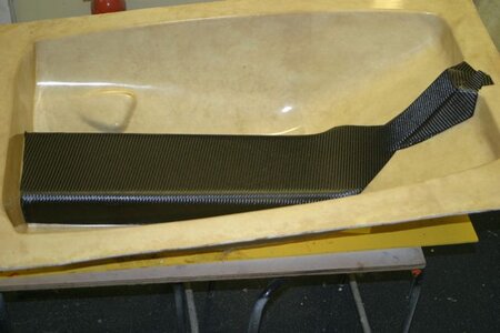

Just thought we'd add the following as we don't think it's ever been shown on a Jet Ski forum before (I might be wrong) thought you'd find it interesting.
The following pictures show some of the process involved in making one of our (in house) Carbon Fibre pre-preg hoods.
There are more stages than this, a more detailed write up can be seen here
http://www.queenford.8m.com/hoodprepregbuild.htm more photos will be added to our website soon.
This particular hood has been built with the demands of surf riding in mind so extra layers were added, this hood and baffle bonded together weighs 9lbs.
QJS
X-
GONE
more..
