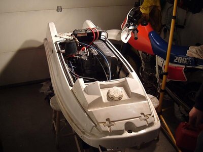

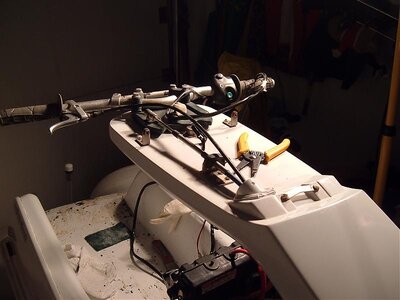

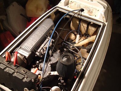

The goal : to build a sick flat-water freestyle square
95 sj: mods when bought: umi steering/throttle, ap designs chin pad cover, solas prop, pro tec ride plate, (i installed a rule 500 bilge after I bought it)
MODS PLANNED:
hull/hood: slutty hood mod, hand holds, foot holds, hull reinforcements, scupper, paint
pole: ac racing aluminum handlepole
engine: Building as I go, stay tuned for all the goodies.
pump/nozzle: bored nozzle, 13/15 solas concord 3mm cutback

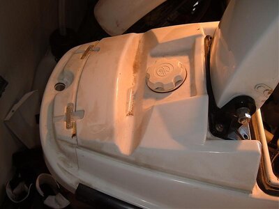

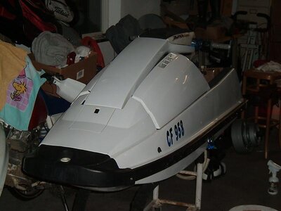

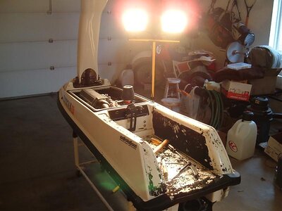

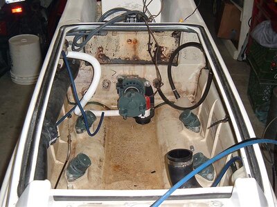

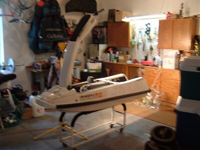

so far i've deturfed, derailed, taken off nose peice, taken off pole/accessories, and taken out the gas tank. planning on pulling out the engine tomorrow

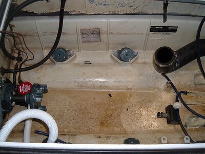

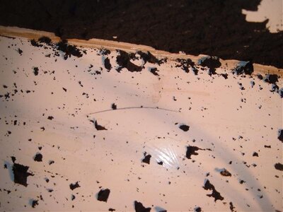

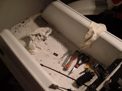

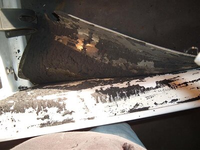

notice the crack in the tray in the last pic? more pics!

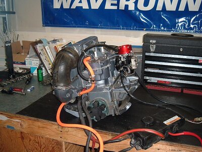

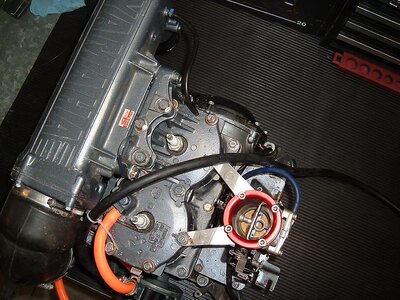

pulled the engine out at my bro's house, more tear down:biggthumpup:

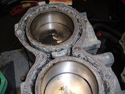

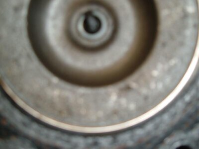

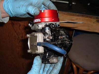

more pics. it looks like a piston shot up and dinged the left o ring at one time. there was bad corrosion everywhere :banghead: i'm having too much fun working on my ski, its awesome! price-wise and quality wise, what would you recommend for a nice girdled head?

alright, for a sick freestyle setup i'm thinking riva ported pump gas 64x cylinder with stock 84 mm pistons (from blaster) and of course boring out my cases for the 64x cylinder to fit, riva's 48 mm power-bomb carb, and the factory b pipe for my engine goodies. Any thoughts?
D-Roc
I forgot!
single or dual powerbombs? i ran a single last year and really liked it but am going to try dual powerbombs this season. if your going single what manifold are you going to run?
C-Rock87
Water Junky
Boise, Idaho
i'm going to run a single powerbomb, the dual would be too much $$$. having a bugdet sucks, there are so many things i'd like to do but you have to stop somewhere i guess. i'm not sure about the manifold, can I run a stock manifold with the powerbomb? if not what would you suggest?
