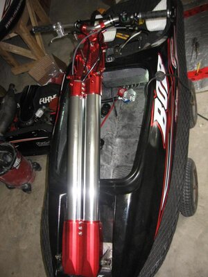

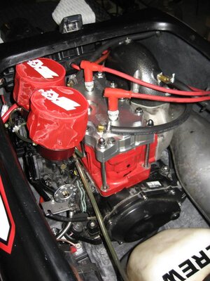

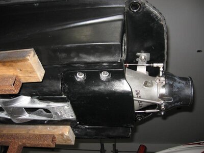

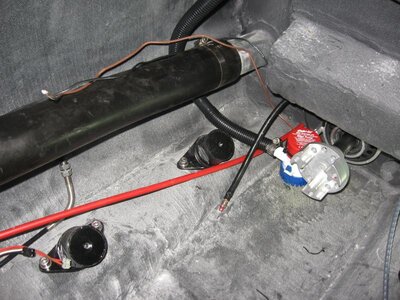

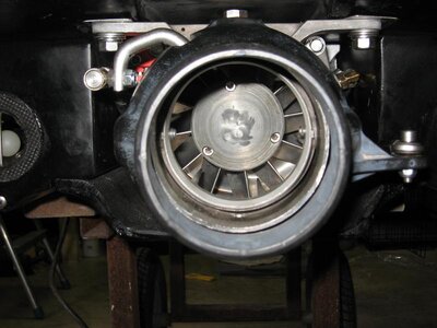

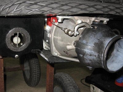

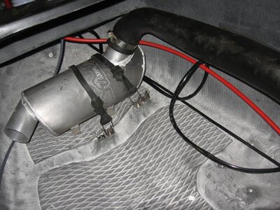

    I just finish my first BOB tonight and awaiting part for the second one

    whats your enine setup?? sounds mean!
    engine setup is 62T case, 61x cylinder
    wiseco piston at 83mm
    cylinder ported
    35cc domes(185 psi)
    v-force 3
    enhancer
    b-pipe with atp waterbox
    and the most important, a 144mm mag pump with impros 9-15
