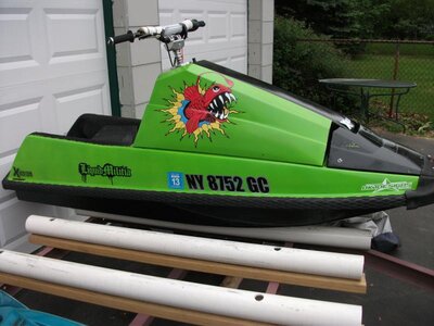

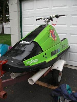

    Well this is going to be more of an assembly than a build. Everything is basically done already. But here it goes.
    90 square. Picked it up pretty cheap, had turf, footholds and a blowsion one way, but was beat up and a had crappy repair with a ton of resin on it.
    Here's what I've done so far:
    Reinforced the engine bay with some 1208 biax and cleaned up the bootleg repair.
    Added a set of Tom21 tubbies.
    Turfed squarenose extinguisher case for a front foothold.
    Installed pump with 08-up stock prop and wetwolf cone.
    Riva top loader intake grate.
    Pro-tec rideplate
    TDR waterbox
    I just got my TOM21 hood delivered today and mocked it up.
    I'm going to pull the motor out of my roundnose and put it in this ski.
    62T/61X 701 .50 over
    Xscream freestyle ported
    MOD B pipe
    ADA head with 33cc domes
    MSD enhancer
    Boyesen Reeds w/reed stuffers
    Riva Intake manifold
    Dual 44's 4 hole carbs
    stock pump with 08 SJ prop and wetwolf cone

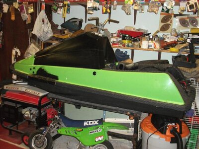

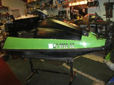

    The Fixed SJ handles awesome. Still rides like a superjet only the pole doesn't move lol.
    It was really easy to roll and re-entrys and carving on it were a lot of fun. I'm going to mess with bar placement and a different steering setup than stock, but so for its a blast. I couldn't be any happier with it. I had no idea what to expect but its a very fun ski to ride.

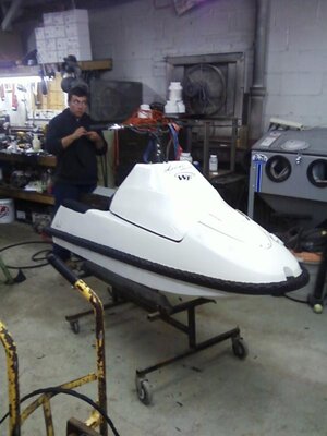

    game on sucker!!!!!!!

    That's my old hood! LOL
    Talked to steve, he's doing the SXR up with a tom21 hood, wait till you guys try that setup! We are building #2 of the SXR flat deck fixed steers now! Most fun ski I have been on in a long time.

    i road it a few weeks ago. its ok . the umi is killed waiting for a new Accusteer sys to try the boat again.
    sxr that yamaha power

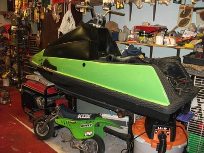

    Still a very fun boat. I don't think it will ever be my primary, but it is sweet none the less. Did a little rattle can paint to it this winter and stuck a coupler stickers on it.
    I have to do some adjusting to make the different steering work that I put on it too. Unfortunately the first ride out on it I broke my throttle return spring and got scared of a runaway after that. I burned maybe a half gallon of gas and sat on the beach.
