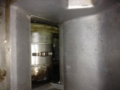

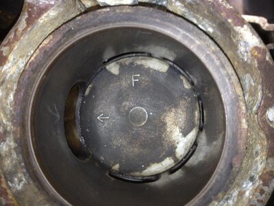

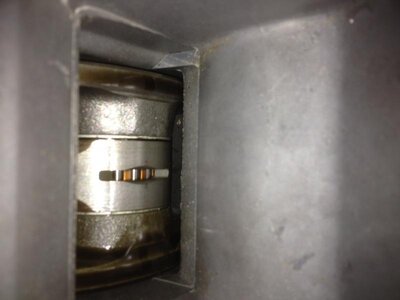

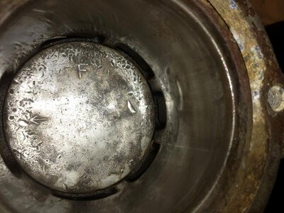

    here are some pics the guy sent me. It's a little rough and the one piston clearly had some deto. what do you guys think? for $300 i don't mind getting a fresh bore and pistons... as long as the crank is good.

    I run a ported 61x/61x motor with a wetjet manifold. Easy to tune a single carb and seems to hit just as good as my friends' 61x/62T. For $300 Are you just getting the shortblock or are you getting other goodies like the ebox/stator/intake/carbs? If you are willing to pay for the bore and pistons I would send the cylinder off to Jetmainiac and get it ported as well.
