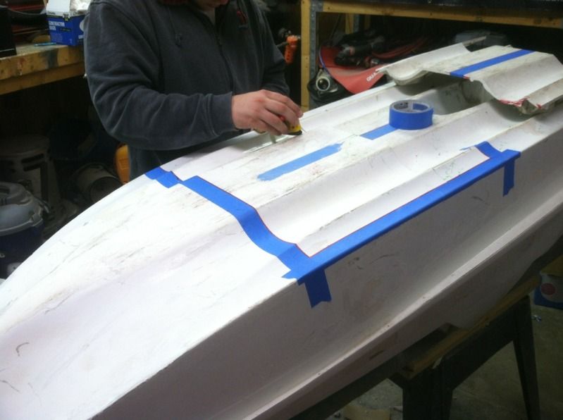

    What are you doin with the pole bracket?

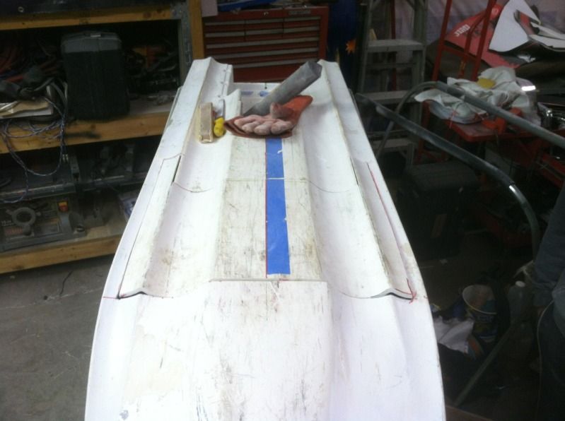

    We are planning on moving it more towards the nose and going with a super jet pole bracket.

    What about the gas tank? Where you gona have it come out to fill?

    Probably going with a 550 tank, it is going to be an inside fill. Since we are moving the pole bracket forward there is no room for outside fill, but it makes for a much cleaner look.

    How would you set that up? The fill nozzle would be towards the nose of the ski and hard to get to wouldn't it?

    Im not sure yet we will figure something out lol.

    Kart tank...

    The 550 tank will most likely be filled where the pickup is and the front fill will be plugged.

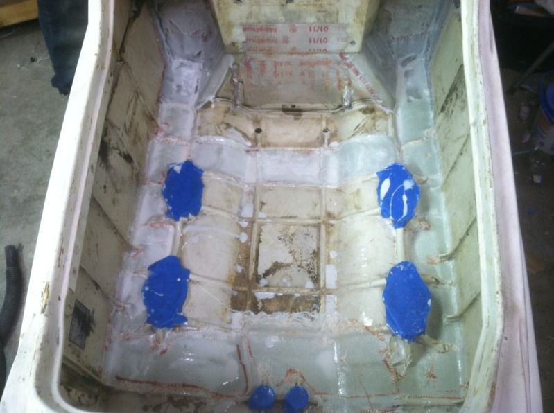

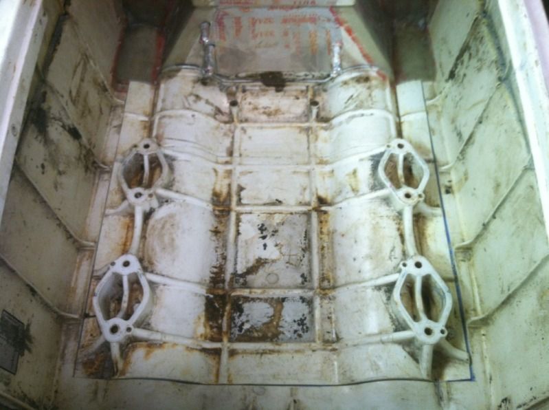

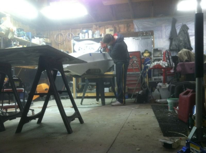

    We did some more work on the hull tonight, the motor mounts are almost ready to be glassed in

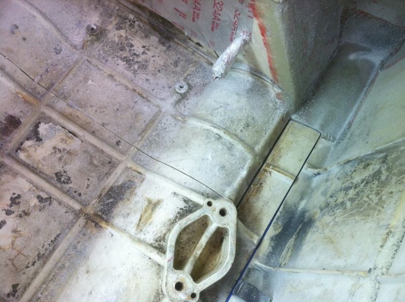

    Definitely should have powerwashed the engine bay before hand, we're gonna have to scrub the crap out of it
    thats the first thing i did when i got my hull makes the whole job alot easyer

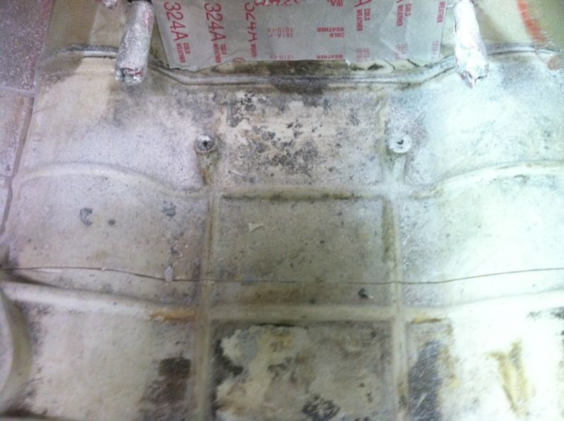

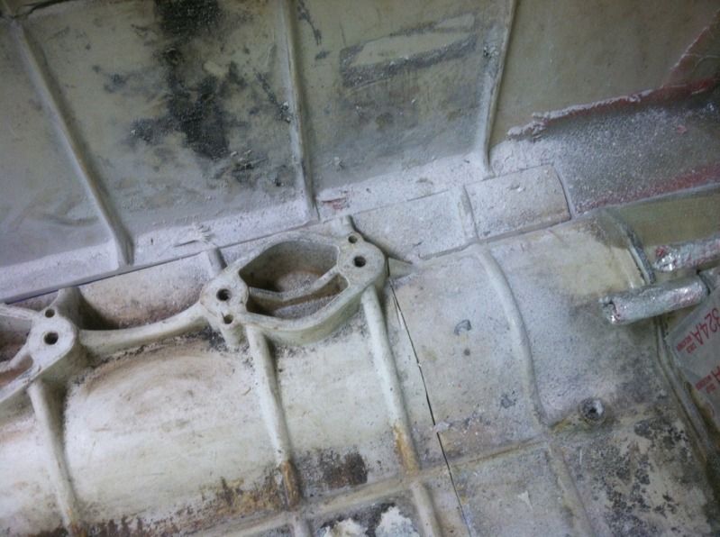

    Cleaned up and sanded where the glass needed to go, then did 2 layers of the 18oz biax.

    Wouldn't it have been easier to just mod the 650 hull?
